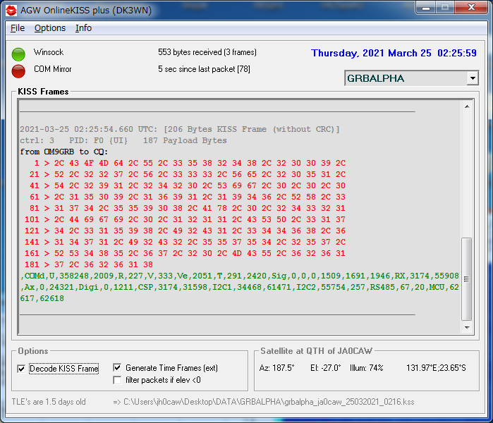

GRBALPHA 01:03 UTC 437.025Mhz 9K6 Telemetry over Japan :
25.3.2021
https://pbs.twimg.com/media/ExSrHi2VgAM ... me=900x900
GRBALPHA 24.3.2021 10:31
25.3.2021
