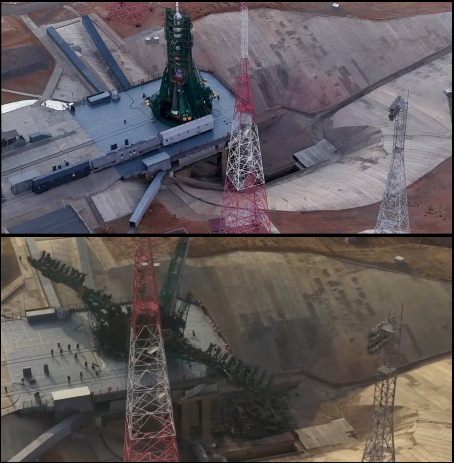

Dnešny let Sojuzu MS-28 nezostal betz následkov. Rampa 31/6 utrpela ťažké poškodenie, kedy sa odtrhla prístupová konštrukcia a spadla do priekopu ! Nieje známe dokedy budú trvať opravy, jedno je isté. Určite to ovplyvní dalšie misie na ISS.

Obslužná rampa, která se utrhla.
Foto z esa kosmodromu v Kourou
Foto z Bajkonuru

Pospíšil píše: 28.11.2025 7:11 Vyjádření Roskosmosu k poškození rampy.
Náhradní díly máme, opraveno bude brzo.
To mi pride take vyjadrenie od stola :Drbe se na hlavě:
https://www.russianspaceweb.com/vostochny_soyuz_ko.html
Nasiel tom taketo informacie:
https://www.russianspaceweb.com/baikonur_r7_31.html
Russia's only pad for crew launches suffers major damage
According to multiple Russian sources, on Nov. 27, 2025, the launch of the Soyuz MS-28 crew vehicle caused the mobile service platform at Site 31 to collapse into the flame duct below the pad. It essentially rendered the only facility for Russian orbital crew launches unusable. At the time, Roskosmos planned the launch of the Progress MS-33 cargo ship to the ISS on Dec. 21, 2025.
According to preliminary estimates, repairs of the service platform, known as 8U0216, could take up to two years and it was not immediately unclear whether some kind of makeshift arrangement would be possible to support multiple cargo and crew launches to the ISS in the interim. There was some possibility that duplicate hardware could be borrowed from the mothballed Site 1 in Baikonur or from similar facilities at other launch sites. There were four Soyuz pads in Plesetsk at one point, also one pad operated in Vostochny and one mothballed pad was in Kourou, French Guiana.
Several hours after the accident, Roskosmos distributed a statement claiming the availability of spare parts necessary for the repairs of the pad.
Podľa viacerých ruských zdrojov spôsobil štart posádky Sojuzu MS-28 27. novembra 2025 zrútenie mobilnej servisnej platformy na rampe 31 do plameňovodu pod štartovacou rampou. V podstate sa tak stalo nepoužiteľným jediné zariadenie pre ruské štarty s posádkou na orbitálnu dráhu. V tom čase Roskosmos plánoval štart nákladnej lode Progress MS-33 k Medzinárodnej vesmírnej stanici (ISS) na 21. decembra 2025.
Podľa predbežných odhadov by opravy servisnej platformy, známej ako 8U0216, mohli trvať až dva roky a nie je jasné, či by bolo možné nejaké provizórne riešenie na podporu štartov nákladu a posádky k ISS. Existovala určitá možnosť, že by sa duplicitné vybavenie mohlo požičať z zakonzervovanej rampy 1 v Bajkonure, alebo z podobných zariadení na iných miestach. V Plesecku boli kedysi štyri štartovacie rampy Sojuz, jedna rampa fungovala aj vo Vostočnom a jedna zakonzervovaná rampa je v Kourou vo Francúzskej Guyane.
Niekoľko hodín po nehode Roskosmos vydal vyhlásenie, v ktorom tvrdil, že má k dispozícii náhradné diely potrebné na opravu platformy.

Podla zatial dostupnych info:
- servisna plosina lezi dole hlavou
- ochranny stit, ktory plosinu chrani pred spalinami je na strane pre nohach rampy
- plosina sa teda po vybehnuti z kolaji otocila o 180° a dopadla na dno jamy
- preco bola plosina v pohybe, preco nezastala na konci kolajovej drahy, ...
- pripadne ci je standard, ze sa vysuva hned takto po starte (pravdepodobne nie) je zatial otazne
zdroje: reddit, NSF, RussianSpaceWeb

takhle vypadá platforma při pohledu zespoda tady další fotko k tématu foto z video streamu a tady je k tomu další vlákno
